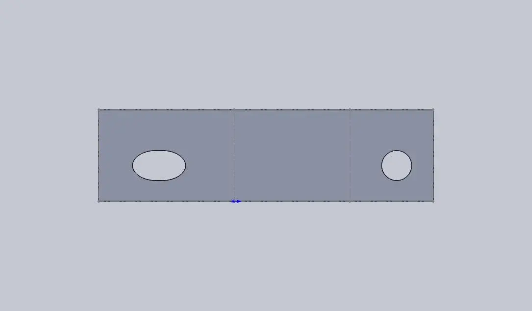

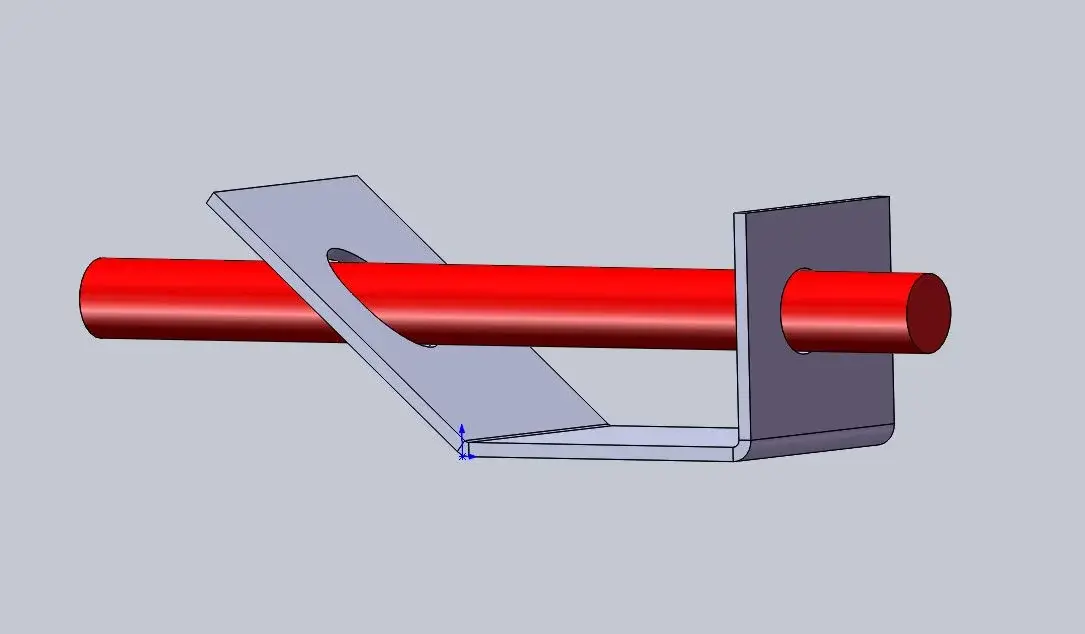

- improved sheet metal functions:
a) improvement of folds in case of cut corners, more realistic
b) Power selection tools (smart multiple selection) for junction type (e.g. select all folds in order to change the internal radius at the same time)
c) development of hoppers (also disapproved), cones, etc. through the "blend" function previously unsuitable to the sheet (in addition to the most powerful tools of smo+ and logitrace, the reference software for the channeling and for the hvac sector, the equivalent of the hoepli tube manual, compatible with spaceclaim)
d) it is possible to create partial recesses on both sides for "dentellate" joints (schedule)
