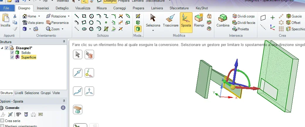

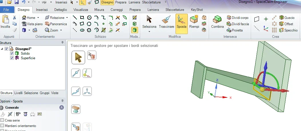

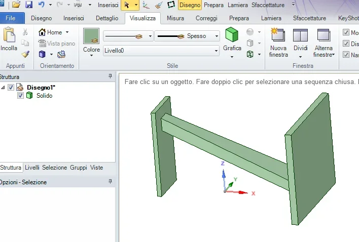

Let him see the images below and ask him how you can do to keep the loft between the two sketches drawn on the opposite faces that created the cross connecting the two parallel solids, placing one, the one on the left in my case, I was wrong to say the one on the right:)
I used spaceclaim 2015

...but if you used the command "transport" and not "move" the result remains equal...?unless before moving or dragging you should not create a single solid and then you do it....!:unsure: It's so an idea looking at the pictures
is there some sort of "unisci" so as to bind the two parts and make sure that in case you move one part the other you follow it?
There is no
all the other 3d mechanics are faster, put the sketch and you get it all
with spaceclaim the only possibility is cups and moves delete the original and then move the edges of the loft to the face of the copy, to the face of the speed

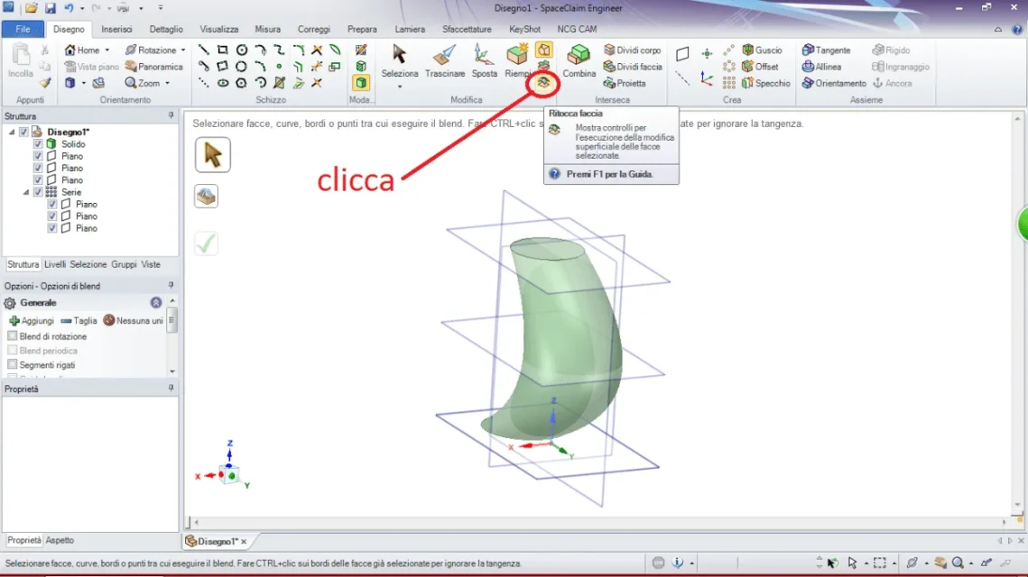

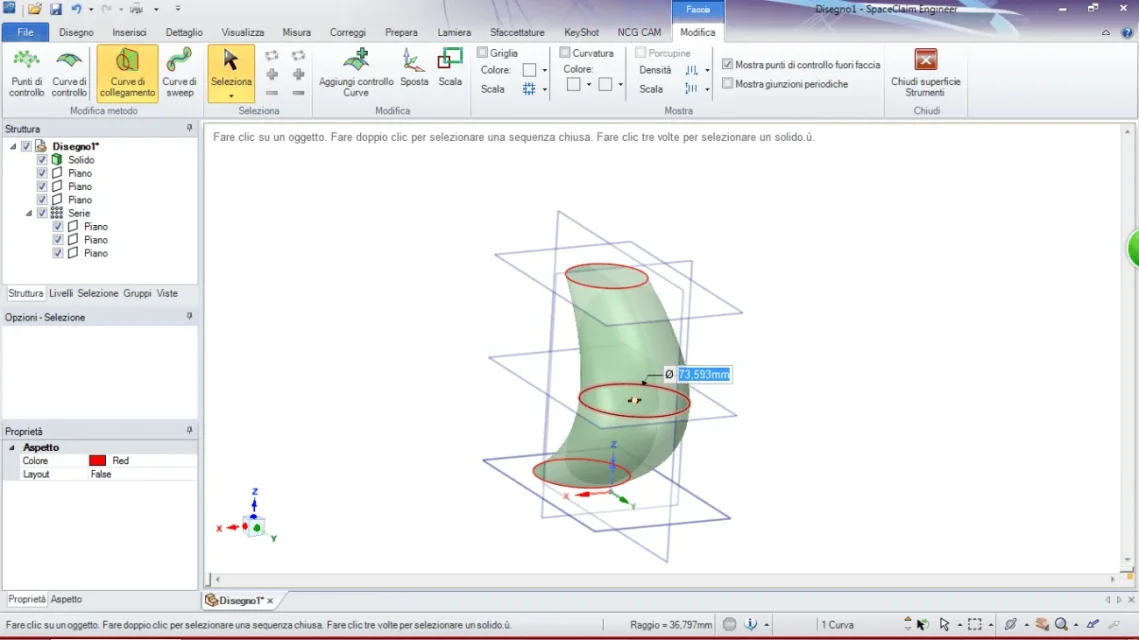

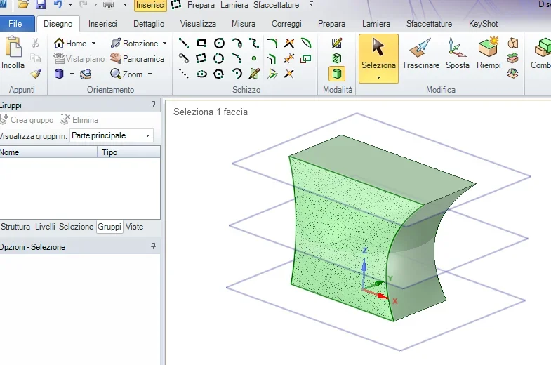

other loft or as it calls it spaceclaim blend, as it does proe
but how do I change the diameter of the circle in the center?
the sketch no longer exists and the edge also,it is all a surface
