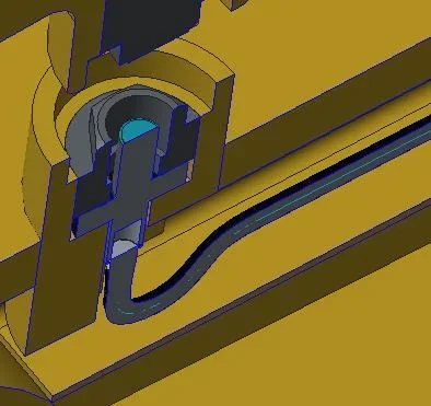

Hello everyone,
I am a newly affiliated and supporter of creo 3.0, the version I use, I consider I create together with solidworks a step further than the remaining cads or modelers dir you want.
Now it happens to me that in view of section a particular represents me as emptied... I tried to do it three times but always with the same result... the technique is always the same used until now.
Now being a particular more than other representative (a transducer or inductive sensor) of the overall does not have an extreme importance... but does not give a correct view of the whole set.. This is a real sin.
Can you give me a logical explanation about this?
I place you some pictures and thank you in advance of your precious answers. .

If the transducer is a set, that representation so is the typical problem that there is an intersection of some very small components, I create therefore has such small values of intersection that to avoid problems, represents it as if it were a set of surfaces.
try to review some odds, even a tenth less, can make the difference.
Thank you very much 320i s, I did as you say... in the sketch there were a few very small fittings... the problem is solved.. At least that seems. . 1.webp
thanks again 320i s.... confirm problem solved. . .
