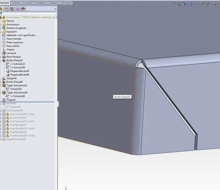

Hi guys I have this problem:
I have a fold as in the attachment... but as you see, it doesn't seem very good. I'd like to do it for laceration.
Do you think I was wrong with the process sequence? !
How would you do that?
I use solidworks 2012
Thank you very much

a laceration discharge between 3 fittings-folds cannot be shaped. I throw the piece out as an attachment. then what matters is the development you put on the laser or the punching machine. That's what has to make sense with reality. to avoid the "reflating" effect of the edge due to bending, you can still decide to exclude the treatment of the edge in the flat repetition (see option by selecting change function on the flat rep.).
Bye.
... does not lie on the same floor as the main edge. . a little laborious.. the (i) plan (i) does not need (no). :smile:
Thank you very much to all.. .
Andle, you got exactly what I needed. In fact, I need the development to send to a combination (punzo + laser).
The technique you used didn't really come to mind. What I've posted... is only 1 of the 100 solutions that came to me... and I thought the best... Yours far exceeds me;)
