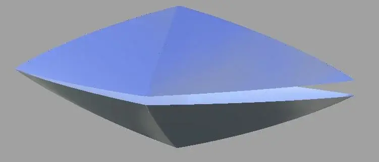

Hello, everyone. I should realize this particular shape attached, with the overwhelming function, which I know very little, I can't. Someone can help me. . .
Unfortunately I can only train 19kb... How can I make you understand? However they are 6 faces that join in a point of deteminata height... I hope I've been clear. . .
in jpg format you can post it larger, or zippi
I will be tarated... but I would do it with a surface, even rather banal. This is more style than mechanical, isn't it?
You're not calibrated, an object of this kind, I think, should be modeled, you don't get it with a simple warp.
unless you agree to approximate the shape and size a lot.
in an approximate way, from the little one understands from the image:

I hoped I could succeed with a magical command of proes as I should propose various solutions where I can approximate many dimensions and what I care about and only design... confirm what I thought! thanks anyway for the precious advice!
we have repeatedly asked the ptc the insertion of the "magic command" but, you know how those of the ptc are, before doing one thing they think 5 years :biggrin::biggrin:
I was thinking,
if the size you need the right, and play with style,
you can also try to use a rounded blend,
where the last section is a point....
