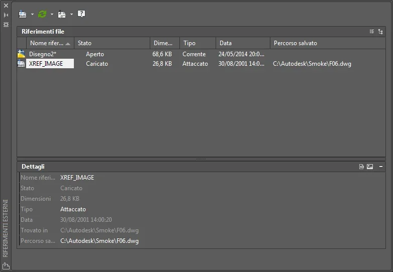

for "necessary object" I solved so
Code:
sub lc_attach1()
    on error goto errorhandler
    dim acad as acadapplication
    dim thisdrawing as acaddocument
    dim insertpoint(0 to 2) as double
    dim insertedblock as acadexternalreference
    dim tempblock as acadblock
    dim msg as string, pathname as string
    ' define external reference to be inserted
    set acad = getobject(, "autocad.application")
    set thisdrawing = acad.activedocument
    insertpoint(0) = 1: insertpoint(1) = 1: insertpoint(2) = 0
    pathname = "c:\autodesk\smoke\e20.dwg"
    ' display current block information for this drawing
    gosub listblocks
    ' add the external reference to the drawing
    set insertedblock = thisdrawing.modelspace.attachexternalreference(pathname, "xref_image1", insertpoint, 1, 1, 1, 0, false)
    zoomall
    ' display new block information for this drawing
    gosub listblocks
    exit sub
listblocks:
    msg = vbcrlf ' reset message
    for each tempblock in thisdrawing.blocks
        msg = msg & tempblock.name & vbcrlf
    next
    msgbox "the current blocks in this drawing are: " & msg
    return
errorhandler:
    msgbox err.description
end sub
and now it works
