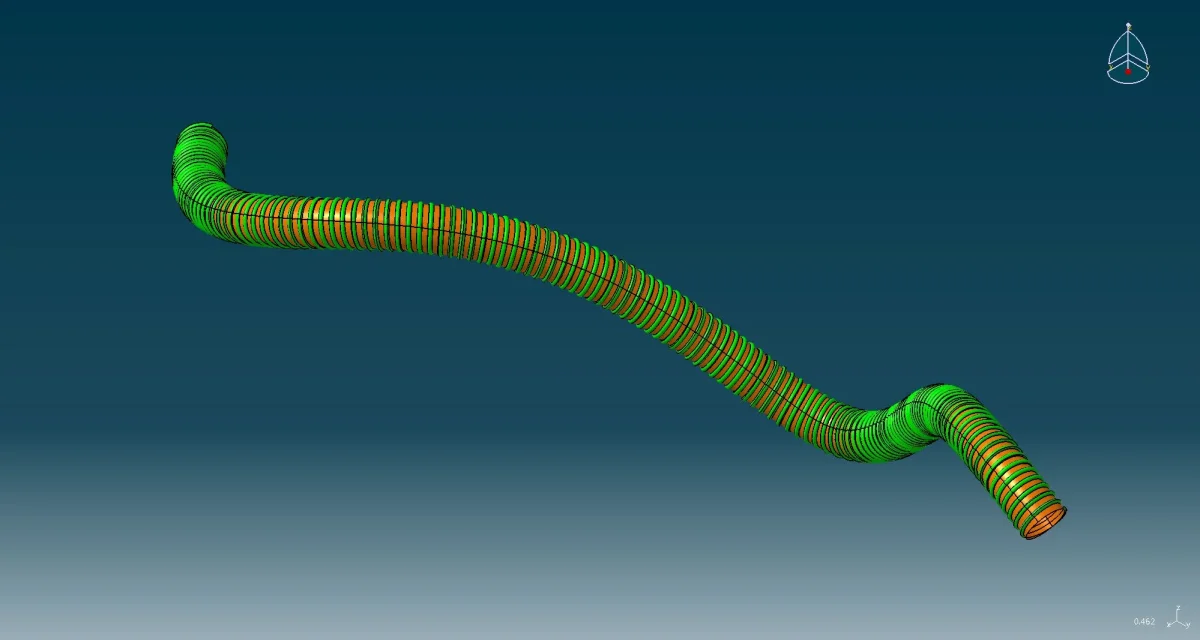

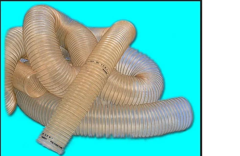

I have to shape a spiral tube, like an enclosed image. What method do you recommend?
Of course it must be oriented in space, I thought of a curve generated by a series of points related to a coordinate system, and as realistic as possible.
Thank you, every suggestion is well accepted.

There's a discussion a few years ago. in comparison mechanical cads look at it.. There's also pro/and give us a look
hi rs4, interesting discussion, I didn't know her.
to be lazy is a little different the tube spiraled by the corrugated, because, precisely the metallic reinforcement describes a spiral.
Anyway, I'll be glad to see you.

excellent solution, pleasant appearance, good parameterization and formula in relationships.
the only peels are that, even this solution, it is good for a corrugated tube and not for a spiraled and the heaviness of the surfaces, but, for this reason, I begin to believe that you can not do better.
thanks for the collaboration

with sweep on reference surface
allego iges

Hello, forgive me if I reopen this old discussion, could you explain how you made the last version of the pipe? attached there is only the exported file and not the part in creo.
what I would like is to get a real spiral tube.
Thank you so much for your hand!
