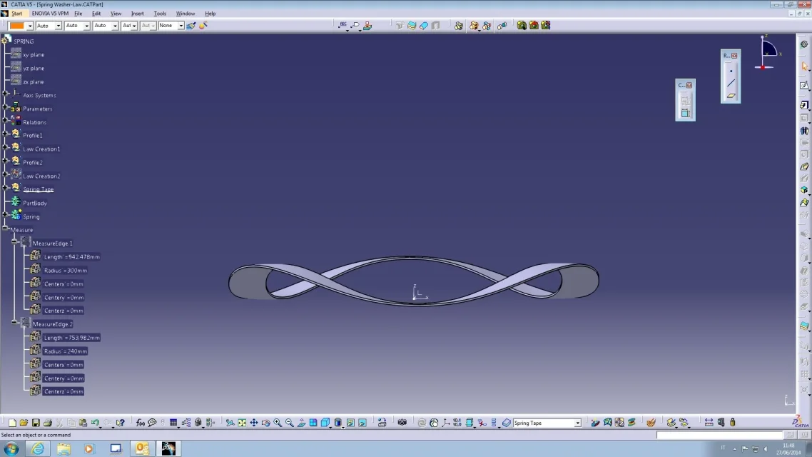

I would like to model a spring washer for the preload of the bearings, but not where to begin!
Thank you for your help

I would develop it as solid to surface thickness with a sweep with "line" type section
for the director of the sweep I would build a spline lying on a cylindrical surface area
These are the photos with the sequence.
I'll send you this different one.

It is the same, the percose I used is different.. .
I created two spline and a loft to make
tape surface to be "thick"SW-0.webp...
then, with mirror and joint I joined the surfaces, and eventually I gave a thickness
to the "molla"-
I added a design table SW-1.webpwith different conformations for the inner diameter, external,
and for the height these can be customized. .
in this way that you can use the file for different needs-

the exercise is stimulating. . looking for there are many ways
different to build spring
Today I send another one, in which I used a law
customizable(by drawing a sketch)
applied to semicircle profile generator... .
In this way I get the basic profiles for the tape

I send you back to the picturesSpring Washer-Law-I1.webpSpring Washer-Law-I2.webpSpring Washer-Law-I3.webpHowever, I also "built" a udf that you can use
repetitively when you want, where the curves of the
tape are built with a law (by applying trigonometric mathematical parameters)
the quality of the curves as you will see and qualitatively excellent
you can't do better..... .SpringWasher- Build UDF.webpSpring Washer-Instant-.webpGood job
only a small thing: the "crazy" does not take decimals and I think it is double; if imposed arrow 1 mm the spring has arrow 2.
I attach my spring that should be
od 18,55 , id 16,20 , spes 0,3 , arrow 2,15

the value of the arrow is to be understood in both directions of the turns of the curve.. .
Moreover, I have noticed that the value I set in the paremeters for the (cold) is
integer(full) does not accept decimals.. you should replace it with a paremeter
(real) accepting digits with decimals and then, lastly, creating a parameter
length with formula = (real parameter x 1.mm )-
the length parameter will have to replace the current parameter (cold)
the above described also applies to the offset parameter from the curve...... .
the file I sent you was for demonstration purposes. . .
if you need decimal values for the arrow you should
rebuilding it by following what I gave you. .
