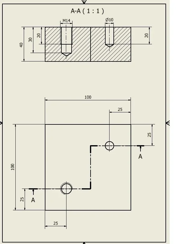

I'm doing a staggered section.
As you can see, the sampling of the two sections is aligned and I can't in any way stagger the two fields.
Can someone give me the sequence of operations to do?

beyond inventor, the sampling is correct because it is the same body. the sampling for contiguous zones of different components or different bodies of the same component.
to be precise should be eliminated the line in the middle

But this time I allow myself to disagree with you.
you are right, in the various dispenses found on the net, of which a couple also reported by me, it is specified that the sampling must be staggered (for what is worth in one I found written half-step). I'm sorry.
But I doubt that a cad that makes automatic views makes this distinction.
inventor seziona based on material or different parts. in this case, being a single solid, considers a part that is made of the same material and therefore the section is identical
I believe that all sw do so, so it is a graphic result "tocitly" accepted by all technicians (and I don't think so are many who notice formal imperfection. ..

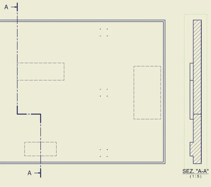

If you just want to follow the rule in the letter, the only I think is to hide what the program does, replacing it by a fact as a sketch, exploiting the graphic contours of the figure.sez.webp
