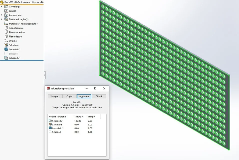

by curiosity I tried to make a somewhat extreme test to see if there is actually difference; a situation like that reproduced will hardly happen to have to do it, but it was still clarifying.
I made a plate with about 450 holes and then, after exporting it to step and reimported, so that the repetition function did not weigh on the result, I made a 2d sketch and a 3d.
the result is that the 2d sketch has a reconstruction time of 1.55 seconds while the 3d sketch has a time of 3.69 seconds.
as said this is an extreme case to highlight the difference, but you can also notice it on a trivial surface with few holes where obviously in that case the difference will be almost nonexistent, but present.
