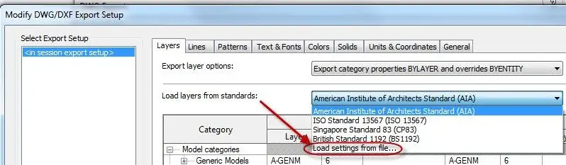

the option is there (see attached image)
also, attached, and a file from the aia in English, which you can use as a basis to make another file in Italian.
