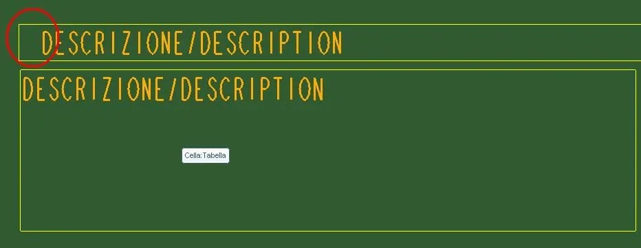

how you manage the start of the text in a table.
are there particular configurations of the .drw file?
both texts have horizontal positioning on the left...but they actually leave differently
see image image
see image image
Hi. .
Any suggestions?
but are your custom tables recovering from disk or creating them on the table flight - insert - table?
Hi nicksoft,
one is recovered the other is created. .
I did some evidence that you depend on the font size set in the config
even if the strings regarding the config text have never been changed, I happen this problem.
I have made several attempts and in none of which puts the text attached to the table edge on the left.
I suppose but I'm not sure that: some time ago I had problems with the font size while not having touched anything in the config... why I opened this discussion and creating a table I brought behind the problem.. .
I would have solved by making ex novo the necessary table.
