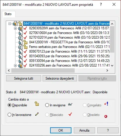

I have always updated the state of the property management components and now with the 2024 I can no longer do it.
Is something wrong or is it no longer possible to do it from there?
you must remove this check; personally change the states from the property page of the main aid
Okay, that's how it works. Thank you.

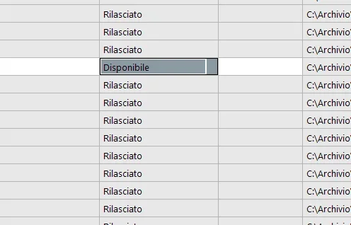

I don't understand where you change the state. from management property of the assieme I can make copy mass paste of a state and back very convenient and fast.
a ok, in many years I have always used that method only for single parts ..
from inside the axieme I always found myself well to use property management because I can also order various codes and release only those that interest me. of course we adapt to our needs.
