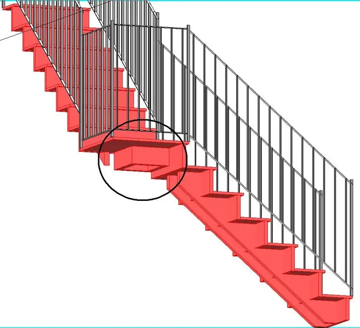

hello to all, someone can tell me how to make a steel "l" scale with 2 pillars that join under the intermediate landing without making that horrible square twist? ?
Now I'm taking a picture to explain better!
actually the scale had to have a handkerchief instead of the landing but the result is even worse.
Maybe I have to cut it apart? ?
thank you and good work to all!

you cannot change by default.
change the height of the pillars of the landing = 0 (not there are)
insert the mounts under the landing, as you want:
-drawn in place (extrusions on path)
- family of "travi"
- generic family
Thanks gfrank, I thought I had to do everything by hand.. .
It's really true when you hear that the biggest revit gap is the stairs and the railings! !
we hope that sooner or later they decide to change methodology.
thanks again for the promptness of the answer!
