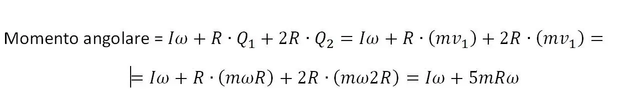

confusion arises that in .pdf it is called all improperly moment of inertia. instead try to think that the right part of the equation is the sum of the angular moments that for the dotted masses is arm x quantity of q motion. see .jpg if he convinces you. is missing r^2 at the end, but everything comes back.

I really thank you so much you gave me what I was looking for... the right point of view:):):). . I've got a lot of other things clarified now.
