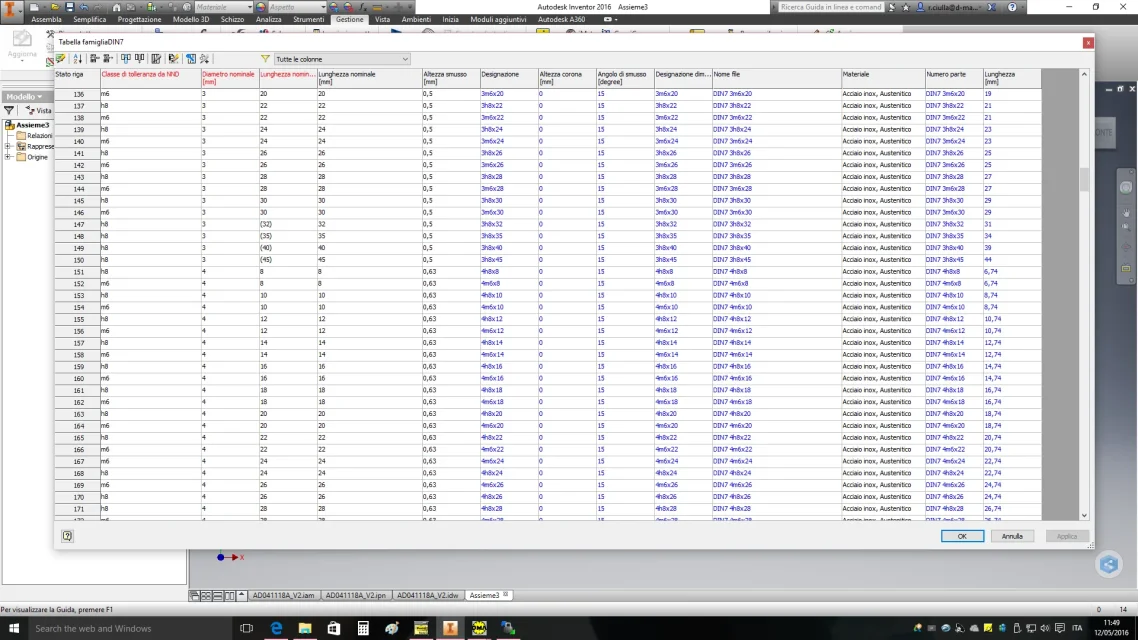

I created a custom library on the content center in which I copied and modified some components (nut invitations etc) that we use in the company and that must necessarily match with the descriptions and part numbers present in the management.

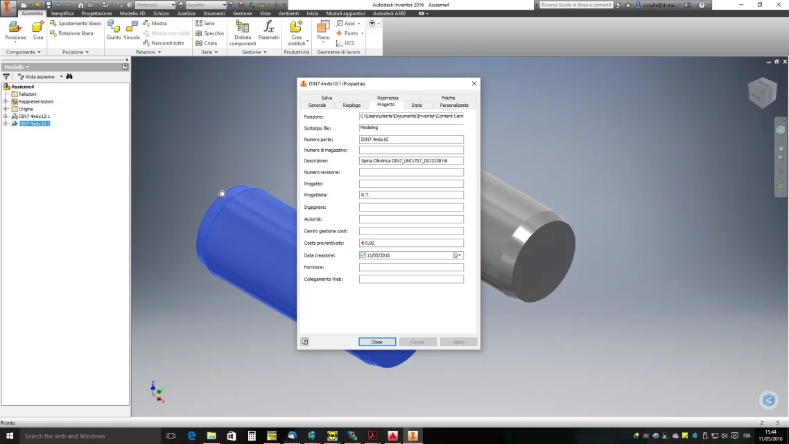

Based on the assumption that I can't delete a family copied into the new library and that by mistake I created, the main problem is that to a same family I find 2 different descriptions while having in the property screen a unique description.
for precision I created a family for cylindrical thorns iso 2338 but that in the company we call din7 etc. I find that for two thorns of equal diameter and tolerance but different lengths in one in the description appears a h8 that does not exist in the description.
allego photosP1.webpP2.webpOf course I offer reward to those who solve the problem I only say that it is from Monday I try and I did not bring out a spider from the hole.

here attached the editing window screen
p3.webpI hope this is the screen you asked me. .
greetings and thanks again to anyone who answers.
no, it would serve the part of the table where the description of the elements is generated
Yes, that.
I do not see the column description, it means that inventor if he generates it in his way, I do not remember how, but still the problem is soon solved and if you delete and re cop the family the problem remains.
you need to create a new column that you will call "description" where in the field "fromula" you will put all the parameters and writings that will automatically compile to the generation of the particular. then in the drop-down menu at the bottom, always in that editing window, you have to set the design iproperty traking "description". so it should work. for the already generated components make an inventor a "every standard countenance" and should settle for themselves.
