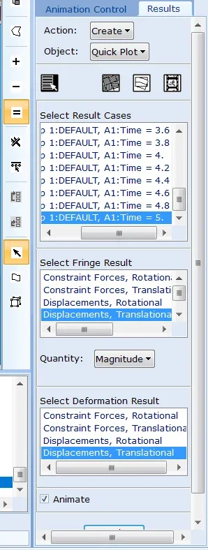

Unfortunately instead also doing the sol400 and putting in preference->non linear I get a subdivision in time
yes the load increases progressively, but I can't understand how much. I remember that when I had made several attempts I had come out load houses: 10% 20% and so on, but I don't remember and I can't get it anymore
in a nonlinear time is the load factor, which varies from 0 to 1.
for which, it is to all effects, a multiplier of the load. then at time 0.1 you have 10% of the load. at time 0.2 you have 20% of the load. And so on.
