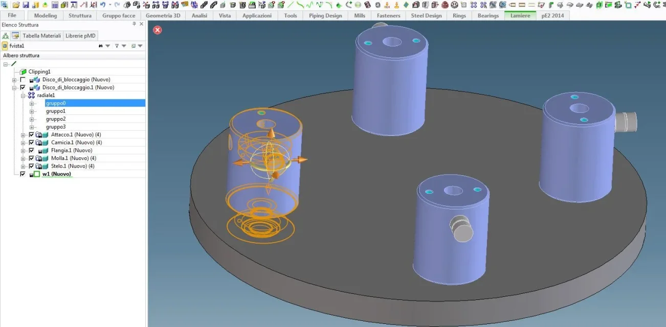

personally I think it is better to select directly to video instead of looking in the tree structure, moreover a good compromise between fictitious groups and parts all at the same level could be transform the subparts to carry etc into a group faces; Pattern.webpas you see in the image then the individual "groups" of the pattern (in the image I explore the pattern structure) can modify and manage them independently or through the change pattern commands move them all together.
the video below explains how to create a mixed group of parts and faces to manage as patterns.[video=youtube;SdmSzfKkcsI]https://www.youtube.com/watch?v=sdmszfkkcsi[/video]tools-rename-object
