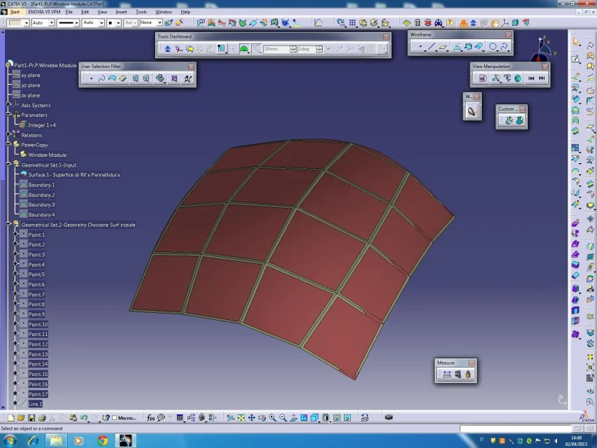

I must in practice realize a surface on which to insert steel panels curved to warm size of 50cmxcm. the sides remain straight and among them orthogonal. So I need a set of points that meet the above requirements.
I looked at some paramod.net tutorials. I think powercopy would do to my case.
I could define a grid of equidistant points and then apply the panels for points. As soon as I can do something decent, I will post the result. .
- - - updated - - - -By the way, does anyone have any tutorials on power copy, as well as those on paramod.net?

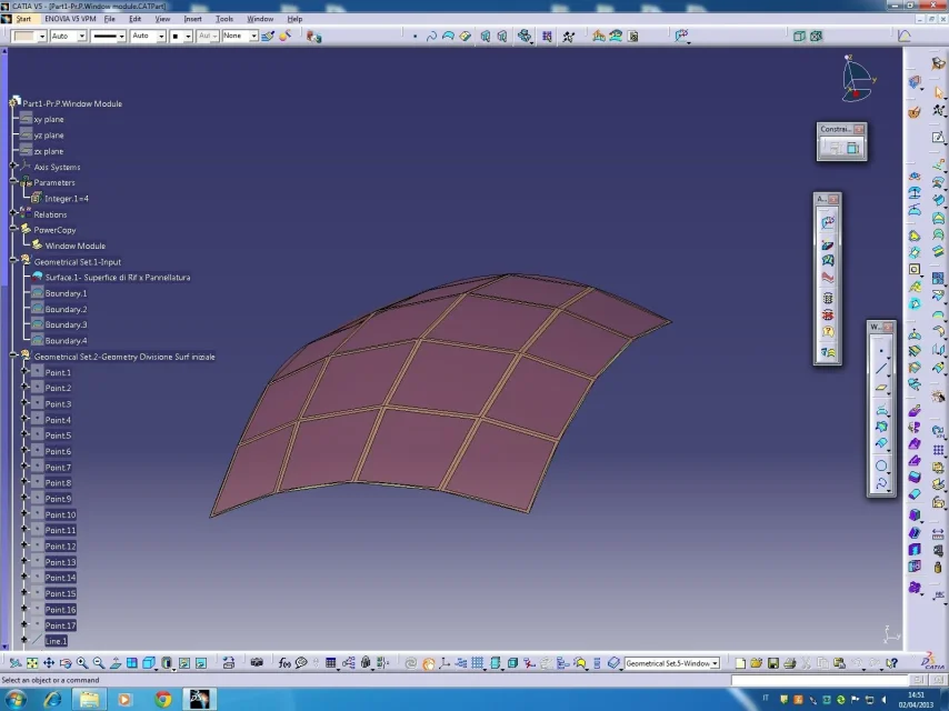

Hello nic... I send you a small example of panelling
of a superfice, using pwc-
the example presupposes to divide any surface
in plan modules on which to apply a window-
In our case, the partition of the surface begins
from the regular edge division for a n° (4 in our case )
ruled by a parameter-
using a surface distribution module as input
initial, we create a pwc that we will then start ( manually)
in the different modules obtained
at first it is preferable that the instancy is carried out
manually, in order to understand the mechanism well
of instancy. . .
later, once you master the instrument ", you can use
knowledge pattern template, to automate the process. .
or a macro that you can find at www.gtwiki.com(digital project)
or creating a pwc- loop
the important thing is to start. . .
good continuation
