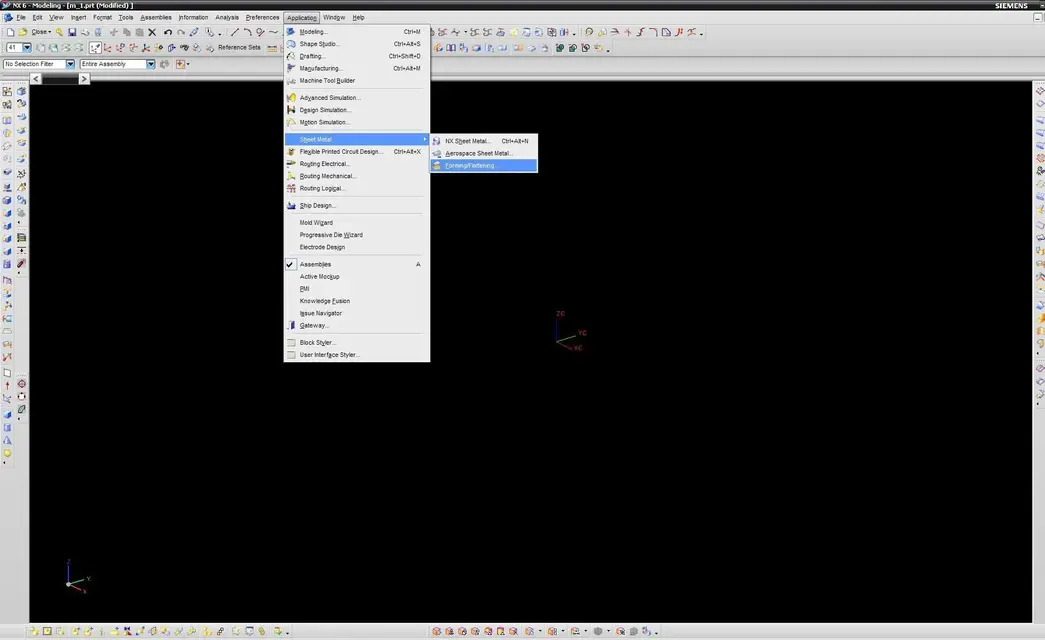

hi, to develop the sheet you need to use the formin/flattening module that is located under the sheet metal (see attached image ) but depends on what license you have. you need to check if you have the form in your license file. we as we have been nx users for many years, at the time when there was still no distinction of the various types of licenses (mach1, mach2... ) we have inside our file a module apart which is called advanced sheet metal that allows us to do the mentioned operation. However just try to run the operation and tell you immediately if you have the form or not

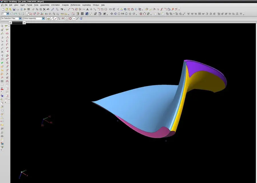

we use it in the field of sheet metals because it is part of our work, it does not remove that in some cases we have complex forms from which to obtain development (see image )
