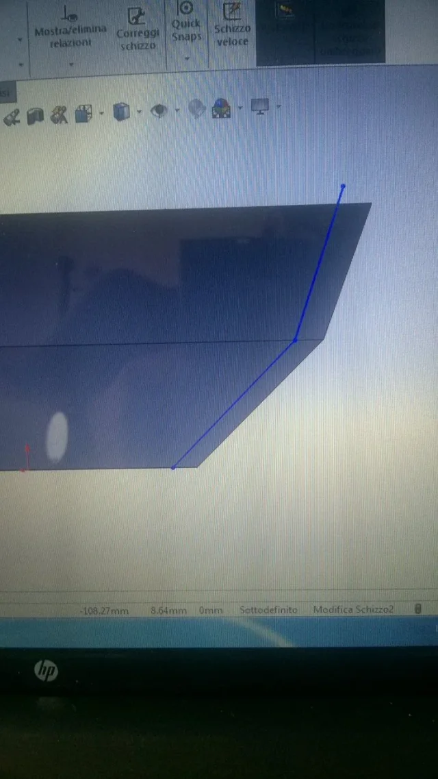

After creating a solid in revolution I run a sketch on a plan and if I try to put quotas or references to the profile previously designed it does not allow me to do so. solutions?

I would like to quote the two lines from the outside of the solid, but not me

solved by increasing the graphics resolution, thank you! I couldn't load a screenshot because I
a problem with the PC network card.
