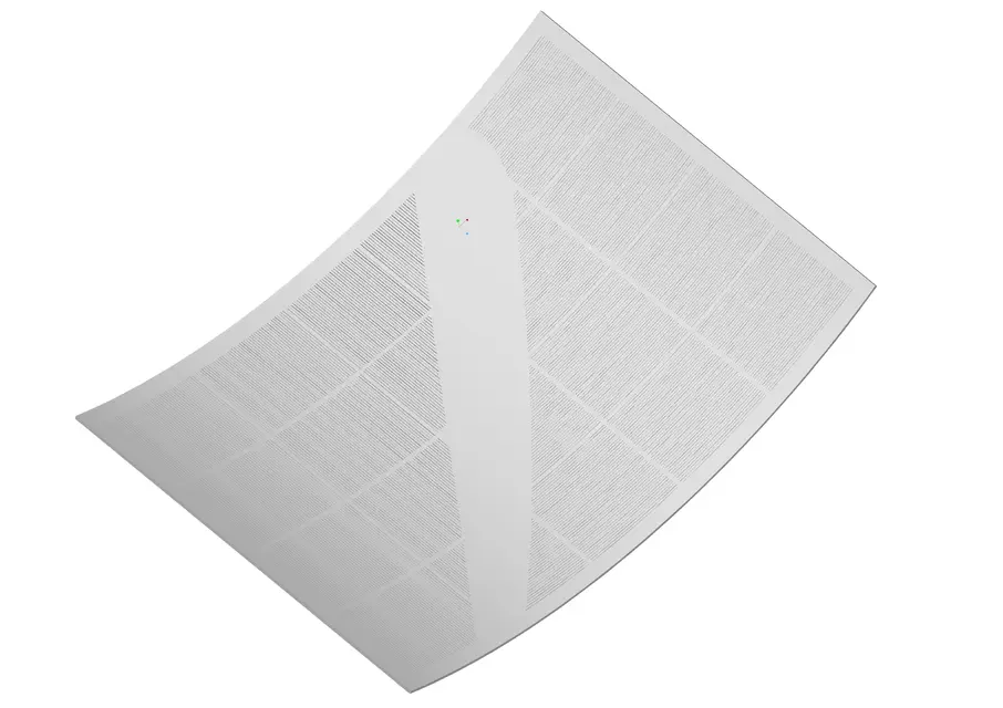

However the question you interpreted correctly, now you have to see if I can develop it (it is not very clear how to make this paste copy of surfaces since they are functions that I rarely used for the machines that project) however from the image I attached you should be more clear. I add that unfortunately in addition to the pattern we say "equal", the series must also end up on two curves that delimit me the area that must not be "incisa". difficult to say but from the image you should understand
Thanks again.

if the series is bounded by curves use the fill series, if I don't remember badly there is also in wf2.
