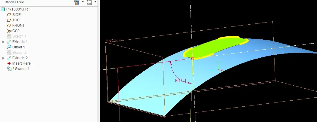

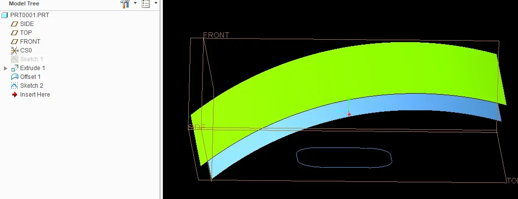

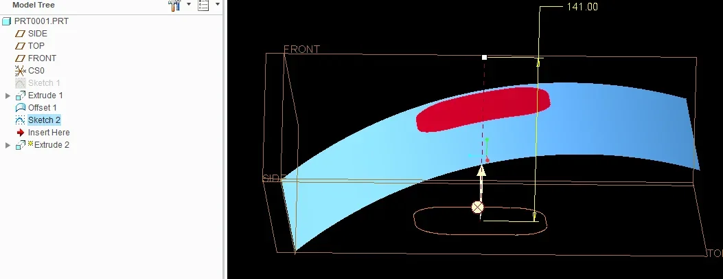

I wanted a support for modeling in creo parametric.
Is there a way to achieve a tilted surface of a x angle compared to an extraction direction?
with catia it is possible using the sweep command with direction of sform.
with creed until now I managed to achieve this only with a normal extrusion and giving it the corner of deformed.
the most correct road I think is to use the "form" function, with which you can select:
- deformed surfaces
- sform hinges
- deformed direction
between options you can also decide to split.
Hi, I'm trying to answer you.
for surfaces also test "changeable traction direction".
hi, the swept command of creo is used to design surfaces (or solids) oriented to the starting surface or to a generic plan indicating the direction of deform. (in this case top)
