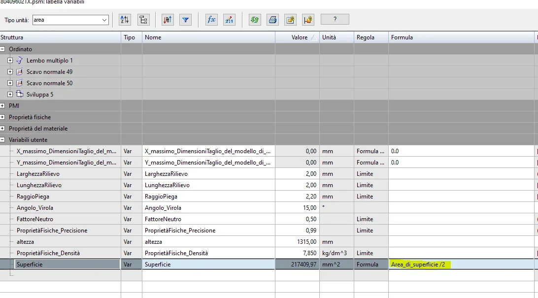

How can I do to put a reference that calculates the surface of a sheet face and not the total one? It would be enough for me to make total surface divided 2 as it is only 1 mm thick... Thank you.
hi, you need to use the "measure" command and create the measurement variable. Once you have the variable you can expose it and use it in all calls or use the variable directly.
Can you just have the surface area property? I think you take all the surfaces into account, so also all the holes, but if you need an approximate value, you just need to divide it by 2 as you already said.
The problem is, I'd need to split it in half because they're thick sheets a few mm wide filter surface. Is there a way to put the value divided by two? Thank you.

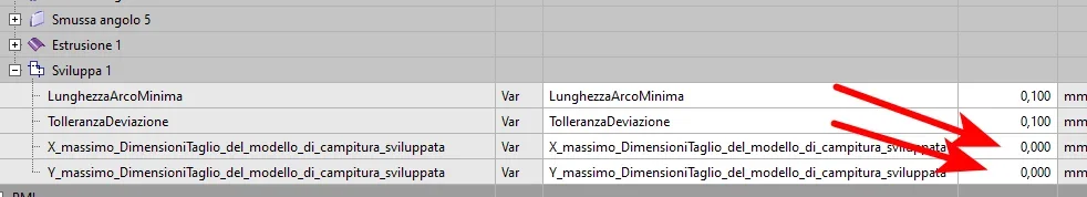

I was interested in this, too, but I really need to read the two dimensions of development and create an area variable customizes that it is the multiplication between the two quotas.
therefore included of spherids.
I can't find them in the variables of the particular.
I have not understood where the error is or if the variables I mean are others, development has no errors
I just tried on if 2022 mp14 and appears regularly
