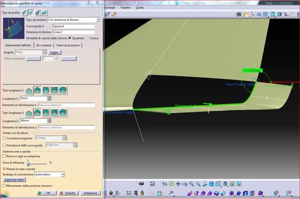

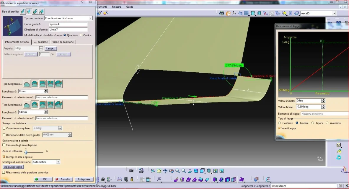

hello raga, I should perform a sweep with sform direction
Cattura20.webpand give a law because the segment that flows along the guideline sweeps a certain alpha corner.
the sweep is necessary because I will serve as a support surface to realize the filling of the terminal part of the rudder, which as you see from figure, represents the terminal part of a naca profile and then ends with pointed shape.
and I wonder:
1- if I apply a law of deformity, the final alpha angle I impose seems not to start from the direction of deformity. Why? what references do you generate this angle?

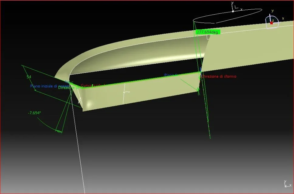

Cattura21.webpthe direction of deformed was obtained by creating a tangent line to the profile.
the angle I called alpha, between the direction of sform and the term direction of the sweep is of "90°-7,694".
Cattura22.webpAt the end it creates a 7.694 angle that I don't understand from where it starts.

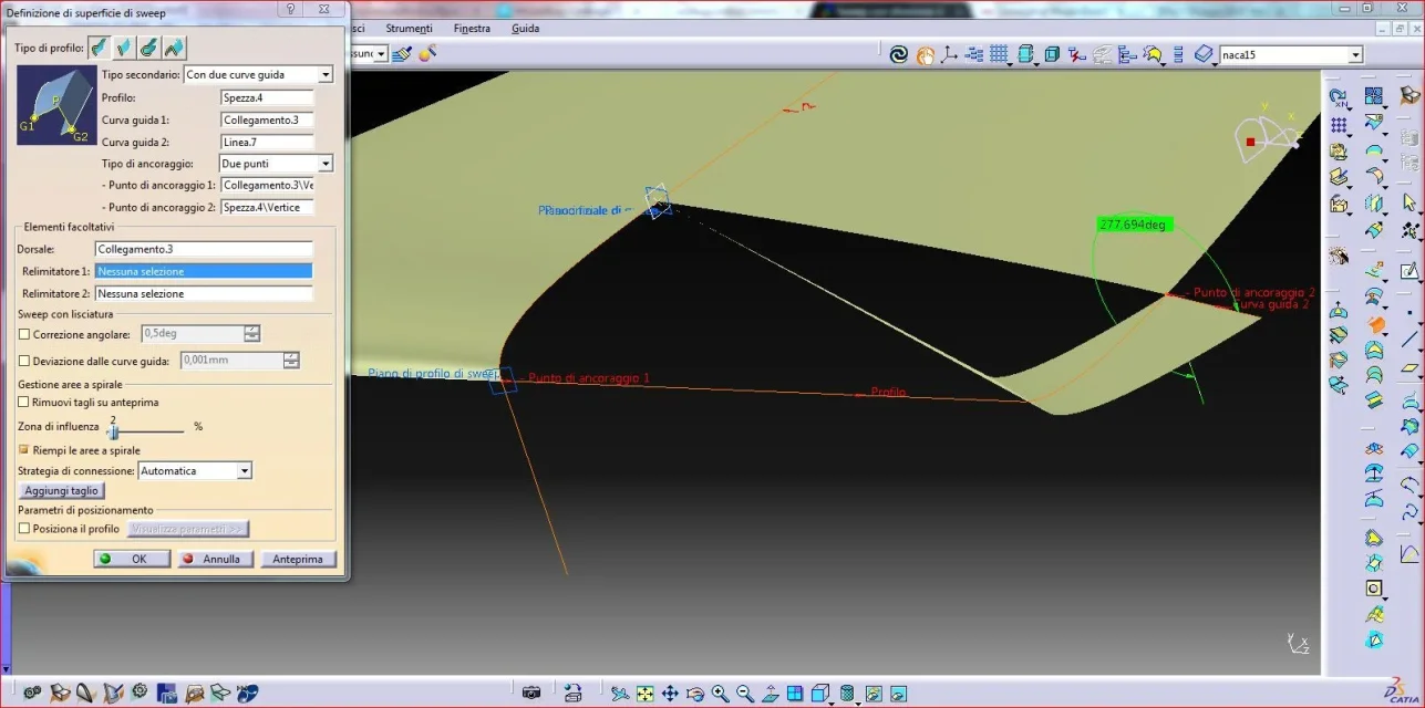

Cattura23.webp2- can I make sure that the final sweep plan changes and coincides with the other white segment designed? If so how?
Cattura24.webpI continue with the second post.. I don't get another attachment.
sweep con direzione di sformo_timone.webpand these are the parameters I set.
Cattura25.webpMaybe it depends on the sweep plan? Maybe if you tell me how to change I solved... :wink:

Cattura28.webpI do not understand what is the principle with which catia v5 r19 assigns sweep plans and starting points of the surface.
because the surface on the right side begins with the segment, as established by me and to left instead takes a point that has nothing to do with it and that is not anchoring point?
