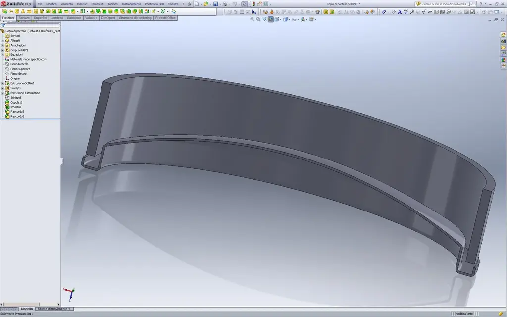

modeling of ellipsoid shape (man's pass). in making the edge of the door with sweep comes out a single surface so if now I want to extrude from the plane of the internal edge to close the remaining hole, and then deform it with the dome funz, you can't do it... .
Good morning!
cite by memory, but you could use the filling surface function to close the sweep ends (use the edges of the extremes as a limit) and then deform it as you like and like. . .
I repeat quoted by memory, I should check on the computer at home where there is solidworks... .
... from how you used the sweep function and the sketch you did I didn't understand well what should be the final result you were looking for.
Should it be something like this? :portella.webp
ed il nativo: View attachment Copia di portella.rarin case eye to "suddividere correctly the bodies", do right sketches accordingly and choose the appropriate plans.
greetings
Marco:smile:
p.s. if you want different and more complex shapes/folds you have to pass (as suggested) to the use of surfaces that allow you greater manipulation than the simple dome (which has "obligated" forms).
