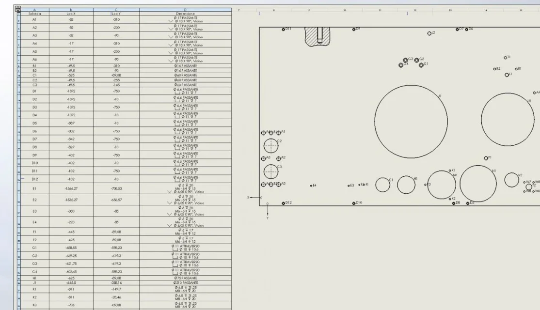

I would like to know how to edit an existing table or create a new custom table.

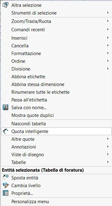

right button on the tableedit an existing table
right button on the table save by namecreate a new custom table.
with the right button I do not display an option "create new custom tab"right button on the table
I have already tried, but does not function the hole description remains the original onechange and save by name
I would like to change the description next to the hole position by clearing the passing words, through and various symbols. to create a new table and not have to change one to one the various descriptions.make a nice explanation of what you have to do lleganfi clear images. I don't have the magic ball!
I mean? How do I change this txt? Can I create a new one and tell my sw to fish from that and not from the default one?the description of the hole is not carried out through the data table, but you have to change the callout txt crowd.
once modified this will go for all the holes of that type and will also go for the record caption holes
