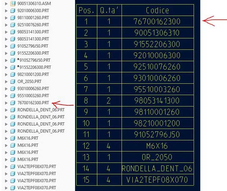

Hello.
in creating the table puts me in random order the components while I would like to put from 1 on then the most important details and gradually decreasing.
can you manage the coloring of the details that make up the table?
In the case below 1 there is an insignificant detail that would go to the bottom and should take the last position while here is in the first place.
the default order is the one where they appear in the 3d tree.
then you can order by increasing/ decreasing number by choosing the reference column from the hanging settings: table->region repetition->ord region
nothing, to me is what of the 3d tree order does not work. I also tried to move the component with the arrow but it does not change order in the table (not even doing it again). the region order but it does nothing but reverse me from above to below the components.
You're right my mistake, because I have a table without the particular code.
without the column of the code the order becomes that of the tree otherwise orders them in increasing/decreasing way
Let's see if in ptc they manage it decently. Then I put the solution always there. Thank you.
