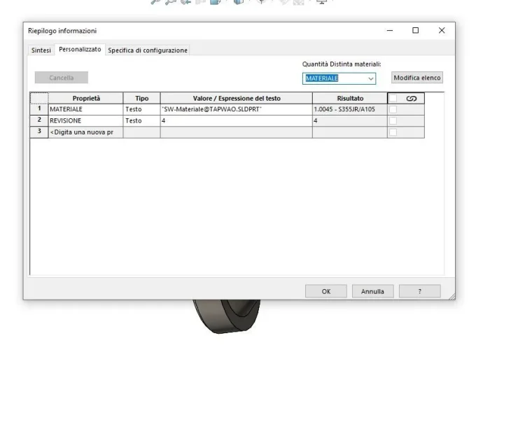

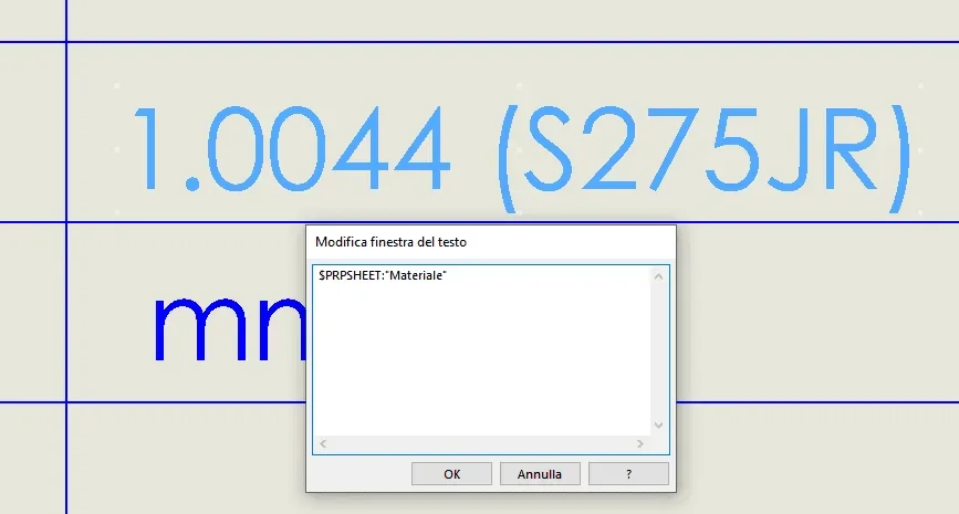

I've been talking to you for years, and I seem to be talking about it here in the forum. Anyway, I didn't find a solution today if not like this... I go in block change and if I change a note I see that the old writing returns to the rescue, then I return to change and remove from the inside of the block the incriminated note and save the block. externally I change the note and then return to change the block and insert it again inside the block. I don't know why he does that, but he does.
