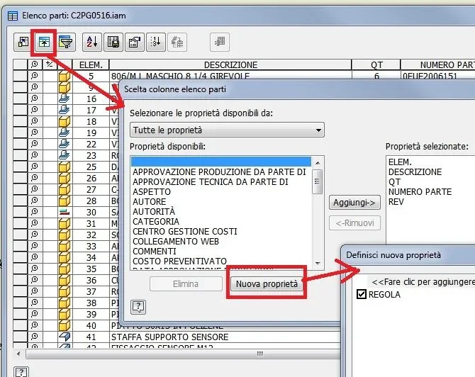

I would need to know how to create a box on list automatic parts that recognize me the thickness of the sheet I created (see attachment) and save it all the time.
also if you can also a box showing the external measurements of the flat model.

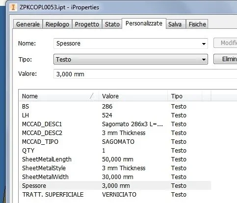

you must associate with your custom iproperties the variable "sheet metal rule"_foto__071.webp_foto__072.webp
attention, the sheet rule appears, "the trick" is to create the rule with the thickness value_foto__078.webp
other solution
1) activate export of the variable "thickness" in fx parameters
_foto__096.webpautomatically the variable is "written" in custom iproperties_foto__097.webp
