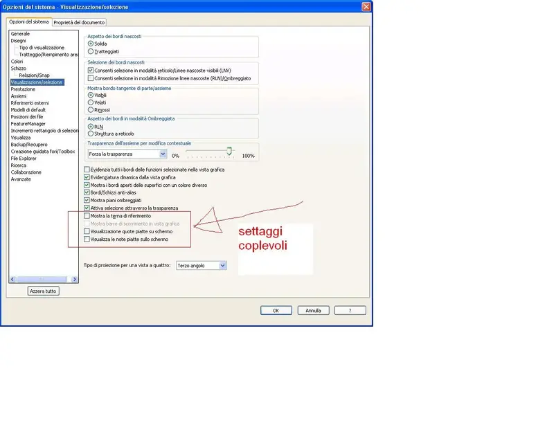

Hello, everyone!
I have a problemna with a table of a folded sheet.
when posiziono the view of the development sheet everything works, then for some other reason that I don't know I can't see the line of fold of the sheet, only the writings "piega su" "piega down"
to review them I have to do a whole set of steps on display options, activating and deactivating below the option for plans and sketches.
not what happened because until the other week I had no such problems
I have to say that the computer I use is not the maximum to work with sw but can it be a graphics card problem?
or some settling?
or any mistake of mine?
Faithful
according to me or is a service pack problem or there graphics card. is yours certified?
No definitely! computer was assembled for autocad use, only for causes of massive production drawings was installed sw on this pc.
I admit that the graphics card crashes, but in exporting it to dxf I do not see it
Plus there's to say that I'm a collaborator I don't know sw because I use inventor normally so it could be that I made some mess. . .
I solved... broke the boxes a set on the display styles that I had set the other day.
I'm not sure what it is because I came up with 3.
my intent was to see the odds always on the floor when I published the sketches regardless of how the view of the part is placed, instead I made only a big mess
thanks the same
p.s.
I didn't want to post a file to avoid messing with the company, since they had problems with other employees a long time ago....
if it can be useful to someone here are the guilty settings of the problem:finger:
