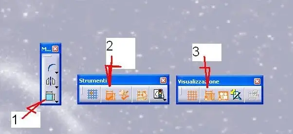

Once you track the line, you can place it on your specifivo point, using a coincidence bond.
look well ta the menu bars the icons in figure.
with the 1 you can assign constraints as in the sketch (selects the element/s and pull the right button choose the constraint).
with the 2 you can store the bond you create.
with the 3 view the bond you created.
if you do not activate buttons 2 and 3 you can always generate constraints but you do not store them.
