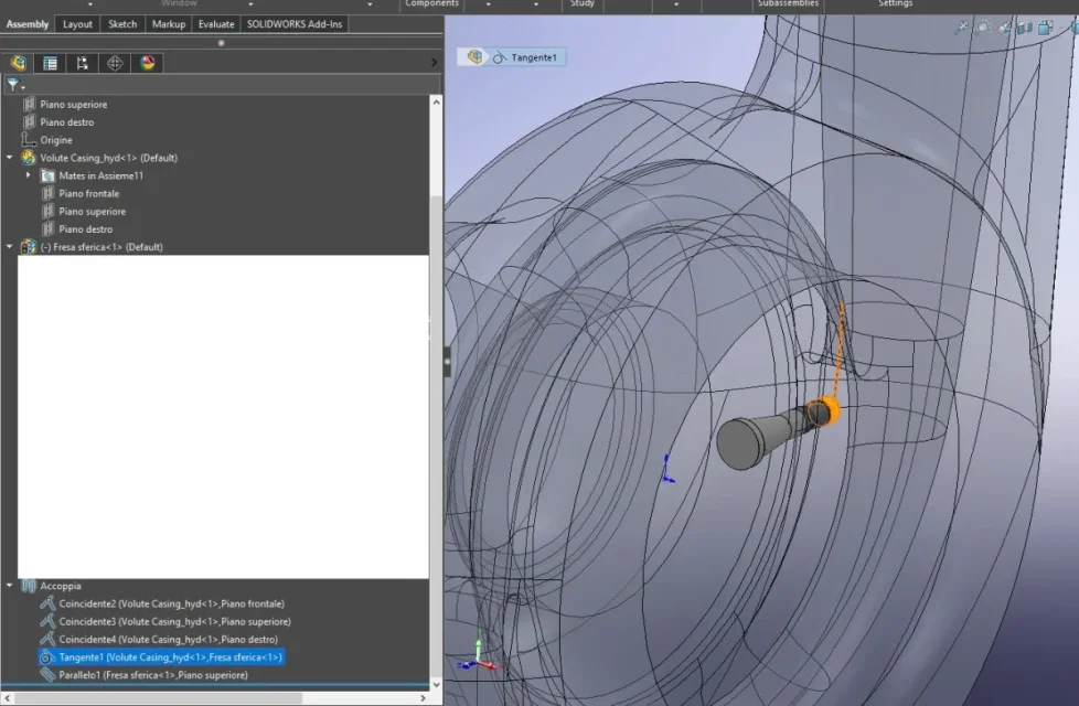

I'm studying the movements that a mill can do in working a turbine case.
I would like to move the mill with the mouse and see the maximum positions reachable.
I've inserted a tangency (but why don't you let me do it between two surfaces?) and a parallelism, but I'd like the mill to not enter the material, some kind of collision control always active.
Do you have any advice? I don't know if it's the right way to proceed.

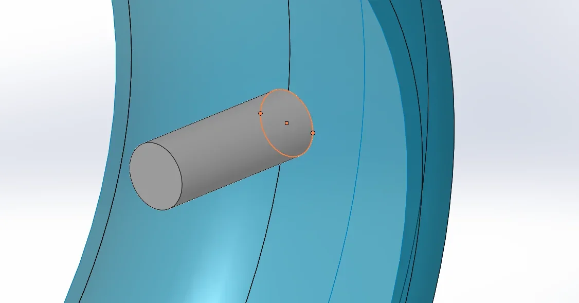

so to nose I would put a coincidence between the circumference you need (or if it does not take two horizontal points) and the curved surface of the inside turbine, so it can not cross1672134370644.webp
Thank you, but the tangence I have on my feet creates more or less the same thing, I want you not to hit the stem in the back.

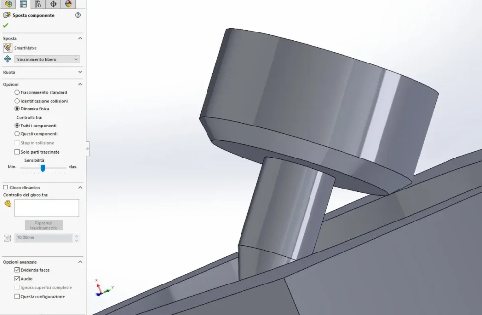

I did a test, and I saw that with "the component shift", activating the "physical dynamic" option, you can simulate the behavior you ask
helpful thanks, it gave some result also a couple based on a path, in my helical case.
