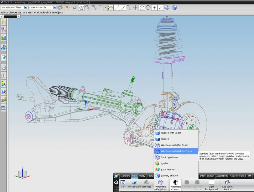

removal of hidden lines can also be done with lightweights.
I only have the 7.5 installed, but the 7 I think is equivalent.
I don't understand "do not tell me to put up the 7.5, because I know that the lightweight has been implemented" was there before. mode has changed and, of course, increase functionality thanks to smart lightweights.
See Annex.
you can also put in the table without problems, just use faceted views.

thanks...cavolo... the assistance during the upgrade course at 7 told me that you could not do... that lightweigth was only good for loading.
However, with faceted view, it gives me extra lines that are probably face-to-face.
I will improve in performance, but if I have to generate pdfs with nonexistent lines, I don't know if the game is worth the candle.
Can I switch from a normal view to a faceted view?

faceted views depend so much on the accuracy of the jts that are stored in the part.I strongly suggest you, if you want to exploit its potential, to make a refile after correctly set the parameters in the customer default.

Can you tell me what parameters to set in the customer default?
the refile is managed by the cad manager and has already been done on all files when we passed to 7.
If I change the parameters in the customer default and then I save the file, no change the jt by adjusting to the new parameters (clearly after rebooting nx) ?
Unfortunately I only have 7.5 so I don't remember the old versions as they had a gui.
I'll put you in the 7.5. You try to extrapolate. . .
you have to go to the customer default in:
- simblies
- standard site
- lightweight representation
depending on the "dimension" of your components set tolerance.
... also depends on what products projects. . .
I recommend a string tolerance of 0.1mm and an angle of 5°.
Of course, the performance will be a bit affected because you will have a more complex faceted.
then carry out a refile of your assemblies with the correct parameters... (if you do refile_part.exe alone gives you all possible modifiers).
alternative is to go nx with the command "assemblies - advanced - representations", make a delete of the faceted present in the part, set the facet parameters as before and regenerate them with created.
Obviously the refile does it automatically and on all components. . .
