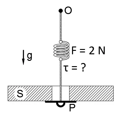

yesterday I had six interviews for the selection of a junior mechanical designer to be included in a company in Verona. the candidates were:
1. mechanical expert with 5 years of experience as a designer/projectist;
2. three-year engineer mechatronic graduate;
3. three-year mechanical engineer with 1 year quality office experience;
4. three-year mechanical engineer graduate;
5. mechanical master engineer graduate;
6. Mechanical master engineer with experience only in non-binding sectors.
I asked everyone the same question about a simple exercise that I bring back below, obtaining a result that left me base. I would like others in the community to try to answer to see if the result obtained yesterday is a fortuitous case or not.
test:
View attachment 53184Note 1: exercise is exactly as trivial as it appears. There are no tricks or hidden details that need strange inventions. the simple calculation necessary can be carried out in mind, without the use of any instrument.
Note 2: who wants to post the answer, answer only yes or no, without (at the moment) justify it, so as to leave to others the possibility to try without conditioning.
hi, sorry for the old post, but I was going through a little static instead of going to have fun (also because the static is fun); I try to say mine even if I read only the first answers I probably would not have passed the interview :d
using on the plate the best friend of a mechanical engineer, the free body diagram, I have two forces, t upward of 2 n and mg down. balance system, t=mg. embroidery then m.
then add m, then the new voltage will be (m+m)g, which should be slightly greater than 100. I hope I don't have to twist the meriam's "statics" book, because it's really nice :d

more than anything else I do not understand the history of the precarious vines etc. to me it seems a simple (?) exercise of physics 1, and the free body diagram does not lie, as you confirmed with your calculation... There's not much to say. But always ready to change your mind a
right by curiosity, I know that it is not always reliable of course, but I have described the problem also to chat gpt, and also he comes to our result, saying that neglecting the 2 n is an error and cmq consider the precarious as "absorbed" from the system is "a very common interpretation in some technical contexts".
