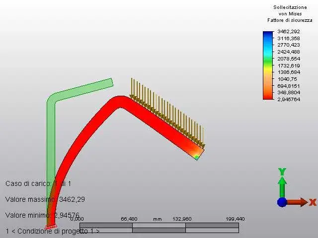

I tried to make this count.
a small "l" support (you can find it in .sat format) under 3,000 n vertical.
I obtain the following results:
- for von mises about 200 n/mmq (in the critical area of the fold)
- as maximum disconnection I have about 3 mm
do they seem consistent data?
What seems strange to me is the graph safety coefficient ... which I sincerely do not interpret (see jpg attached).
thanks for the help
