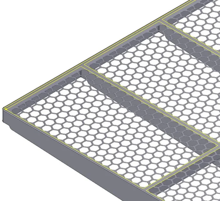

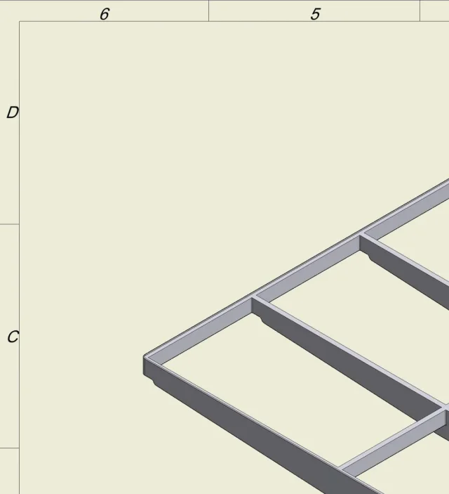

Today I have the following problem:
I put an image on the face of a part.
visually everything turns out ok.
When I put it in the table .idw, the image disappears.
How can I see the image on the table?? ? ? ?
you can see the attached pictures.
thanks in advance for the help.

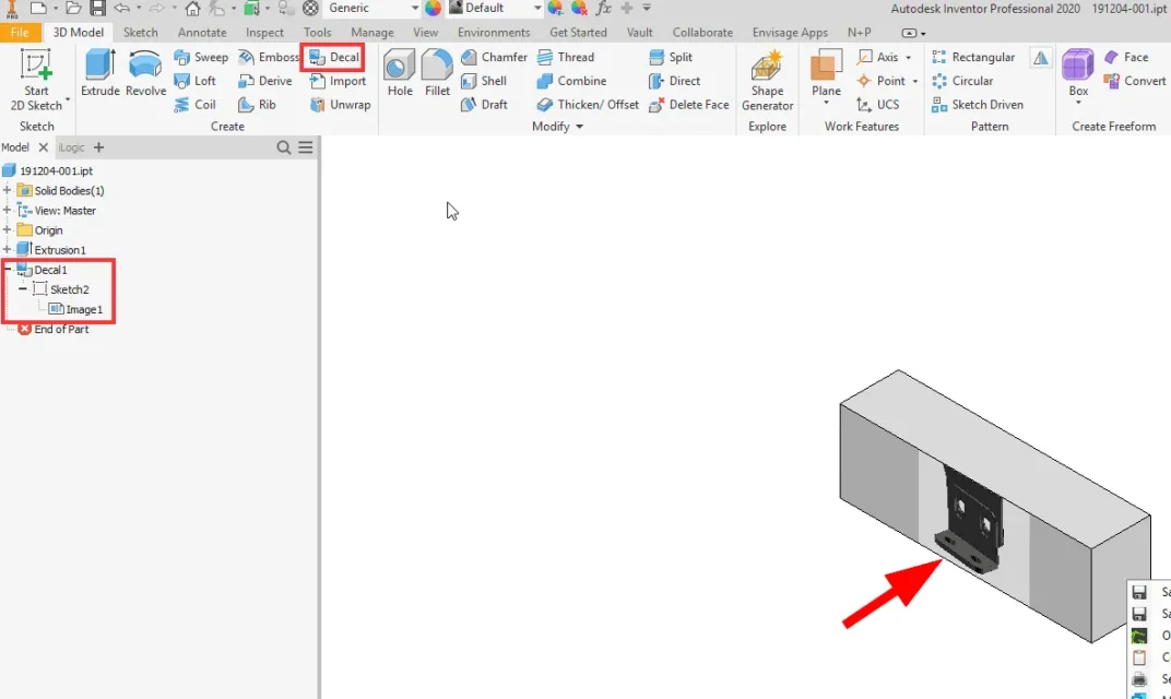

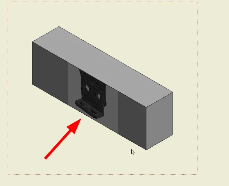

Thank you. cast16 for the answer, indeed so the image format .gif if the door on the table, perfect.
