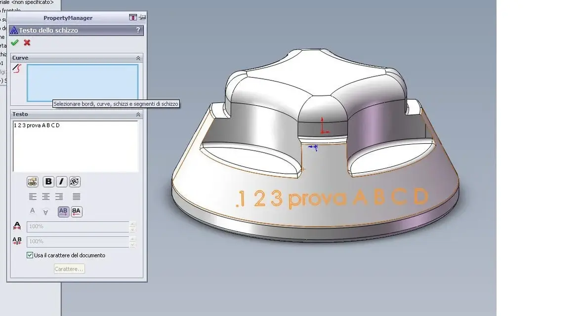

Hello, geppetto,
I'm trying as you told me, I have to ask why the writing doesn't exactly follow the curvature of the piece?
how do I follow the curvature and wrap it entirely?
That's what I got.
but it is not as I wished (see fig. Test 1 and Test 2)
I would like the writing to follow the curvature; I noticed the "curve" option in "scratch text" (see test 3), asks me to select a edge or curve, try to select them but nothing happens.... maybe it is right there the trick?

in the sketch text function asks you a curve that you have not selected. when you do the sketch, add a line, arch or spline that acts as a guide. the driving curve can also be an external sketch.
I tried to insert an external arc (projection of the diameter of the knob), but it does not make me select it.
I tried in the sketch of the text to insert another arch and that makes me select it, but still does not follow the tilted wall and the text is curved but not as required... .
I can't get my legs. .

hi geppetto 82 I attach you 2 proposals in part two you must have the kindness to place the texts in the right place (you will have to repeat the winding... the second file has a deform... See if you can do something. Hi.
calculating exactly the stretching, with the projection function
you get acceptable results.
I think for laser cutting this example is the ideal.
Look if it's okay with you.
the last function, the 3d sketch, I need to show you that the text follows the profile as you want.
