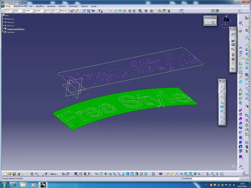

I think I've been too busy
to give you an answer in the demo
I used various reference and reference surfaces
application for text transfer
imported into dxf-
the most appropriate commands, always in the wordbench
gsd, are transferred and covered surface etc. etc.
(see icons in attached images)
as you will see the results are different, the recommendation
in using the feature sup coating, is that of
use the same topology for the reference surface
and for the transfer, as you can see
different topologies give different results. . .
  • TESTO.rar
    TESTO.rar

In fact.. It does, even if it is enough
complicated, little <flow> in other programmes
is called this command of deformation-
I believe that the main difficulty is that which does not exist
at present the text entity, unless one
pedantemente do not pull lines-
usually the text is imported, and the fact that
this most times create an unrelated entity increases
The problems
in any case in the file I send you, you will find all the various
step for <linkare> the curve to the text
the commands are;
shape mapping- environment icem shape modelling,
and the manipulation of the reference curve should be made
in a free style-
I hope everything is clear
