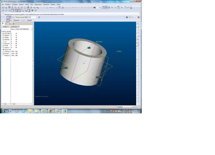

hello to all, I should make a writing on a cylindrical surface.
I press that on the forum there is already a tread but it is not what I have to do.
is to create a writing on a cylindrical surface so that all letters are always normal to the surface.I've already tried to make a text and project it but it's not good because it deforms.
only solution because it does not distort is to create it for construction:
  1. starting from the drawing center a curve with a corner
  2. I build a normal plan to the curve and tangent to the surface(dtm1
  3. on the dtm1 plan I do the sketch of the letter I need.
is there a function that allows me to do this without passing through the construction?
I attach some photos on the method then if there is need I attach the file.prt

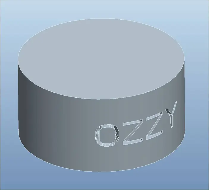

You mean that?
both in addition and in removal?
ok exactly as I wanted to..discuss me but I couldn't do it you could courtly explain how you did?thanks in advance! !
then you don't have to be upset but simply once you do the sketch:
1.Select the surface on which you want to remove/add.
2.menu edit/offset in the dashboard Offset commands select the third icon that is called expansion feature.
3.click on the options tab and put flag on sketch region, you will activate the command to set the new sketch to project, select the same plan you have defined to create the two-dimensional writing.
4.When you are in sketch copy the writing using the command uses edge and loop option by selecting the written in the template tree (pro/and will turn your text into a spline),
5.Set the normal surface option and at this point you can either add or remove material.
I hope to have been clear, easier to do than to say.:rolleyes:

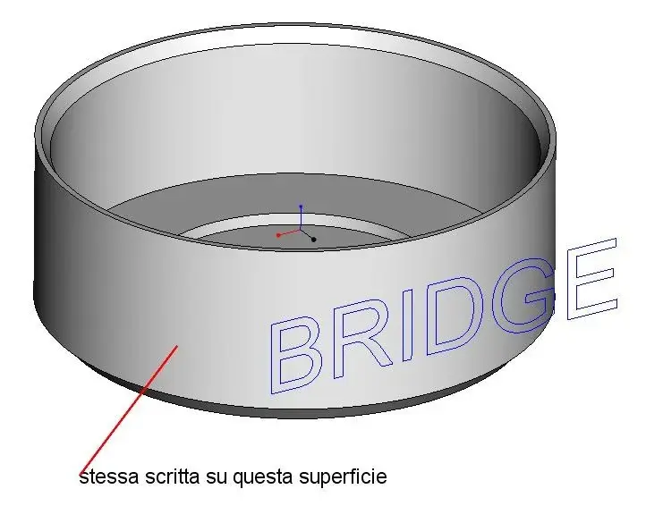

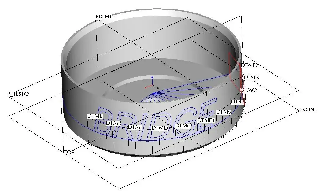

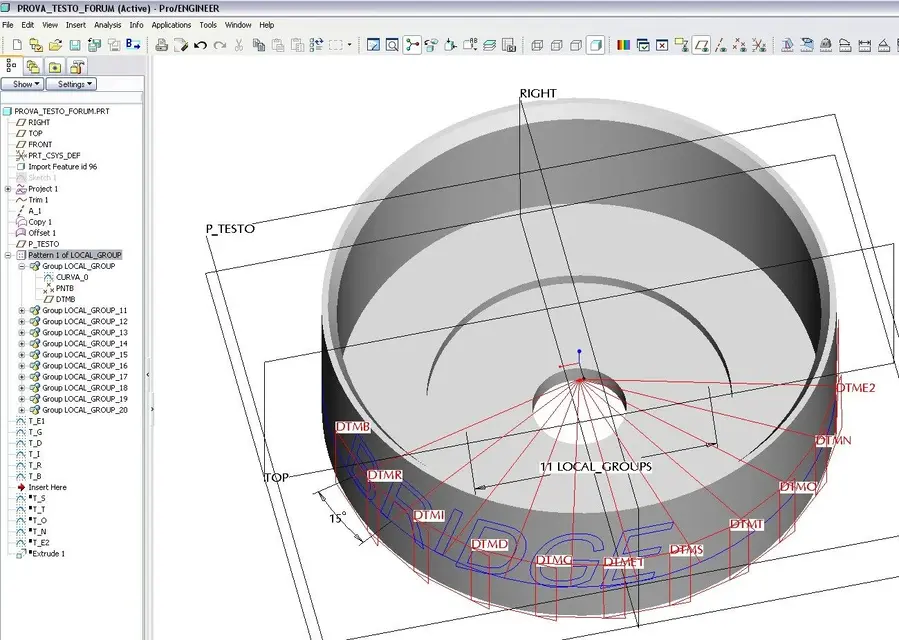

p.s. I return to the writing with the function described by ozzy fine, but if the surface is very wide the deformed writing on the sides, despite it is always "normal" to the surface.I did in another method (a little long) but it works well. shortly I praise and insert the file, maybe it can always serve to someone.:finger:
This method is an alternative to the method described by ozzy, in order to avoid deformation if the writing is splaimed on a wide surface.
premise: offset of the surface on which I have to wrap the writing.
  1. text sketch on a plan
  2. select sketch - change menu - winds(on the offset surface)
  3. surface trim with curves generated by text wrapping.(photo)
  4. the operation is repeated so many times as the letters are.
at this point we got all the letters du superfice.do not ciresta that give thickness by doing to us both "extrude" and "cut".
In this way, the script appears to be the same size as the sketch.
