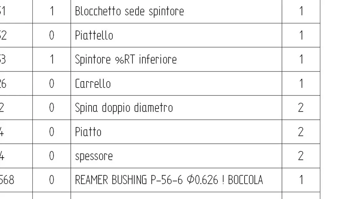

Unfortunately then that %rt goes straight into the list parts....
That's more interesting than I didn't notice either. Fortunately I don't use it because on the cartilage the texts are me.
