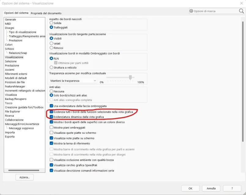

in the link for the highlighting of stones you see this:Cattura.webpnear the pointer appears the symbol of a line or plan, I remembered that there was something similar even in the table, but as I wrote maybe it was a mistake fruit of my memory.
However thanks to mass, activating dynamic highlighting, even in the table before quotating the lenees are highlighted.
Thanks again
Now it works to me too.
I activated these:

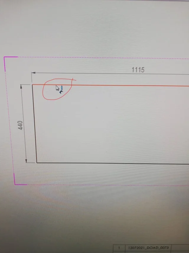

Immagine 2022-02-09 102120.jpgand this happens in the table environment:
IMG_20220209_102148.jpgwith the symbol.
Perfect! ! !
I didn't know it was very comfortable.
