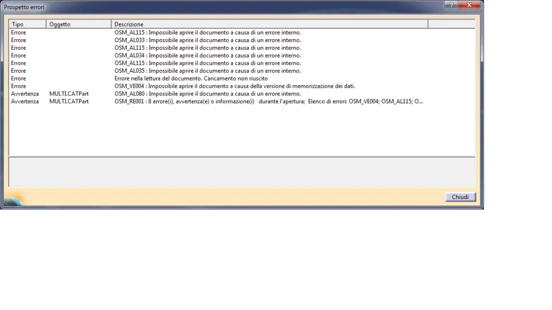

here arises the problem; select all sections, 13, and select the cutting plan, get this warning:
the positioning of closed figures is ambiguous. the result depends on the position of the closing point highlighted with respect to the position of the intersection. the selection can change during the update. use the save/remove option to obtain a stable result.Obviously the problem is not resolved by selecting the option conserve/remove. ..it would have been easier if not:frown:+
