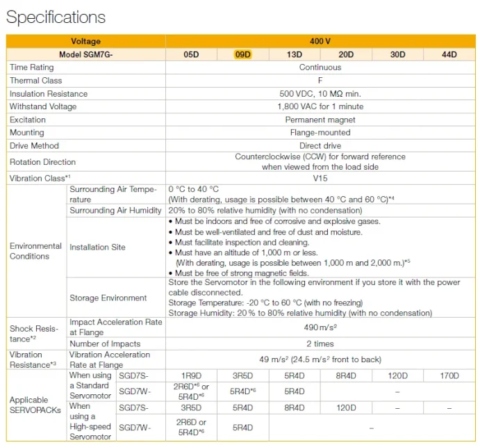

I wanted to know if there is any calculation process or some other way to get to calculate the thermal load and subsequent heat dissipation of an electric motor given the information of the same and its cycle (hour/day) of work.
I work on a cn machine and placed here under a plate data sheet of the engine with ip67 protection.
I tried to search also online but I didn't find anything for the moment.
