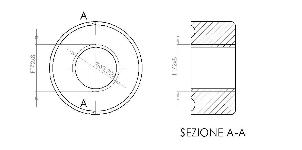

In fact I can't use the creation wizard of holes because that function only handles up to m64. Moreover the thread that I preview is round according to one 9471 and therefore the indication must be of type ft72x8.
I then folded on the cosmetic thread by changing the 'dado' to bring the hole to 63.2 (hazel diameter) instead of 72 (nominal diameter); and then I entered the annotation.
the result seems correct now, what do you say?
in any case the image of the coupling (img3) is still wrong (both because I dissected the threaded organ or by the absence of the subtle traits)...but I failed to find an appropriate function on the sw for a correct representation always starting from the model...help! :smile:
