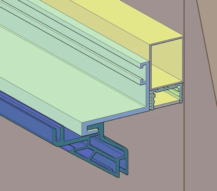

a system of 3 solids that must be cut by another solid. if I do the traditional procedure select the 3 solids, command subtract, and select the solid "tractor". result: objects cut but join. Is there a way to cut them without joining them?
I don't know how to insert a picture otherwise it would be all clearer

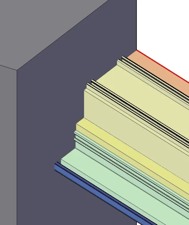

Immagine 2022-06-09 133010.webpthe grey solid must cut the other elements, but they must remain separated from the cut.... Now I have to do it one at a time if I want them to be separated. Thank you.
After doing the subtraction operation, use the separate command (from the solid menu) to separate each element.
In this case I would also use the tip, alternatively you can make copies of the grey solid and make 3 separate subtractions
