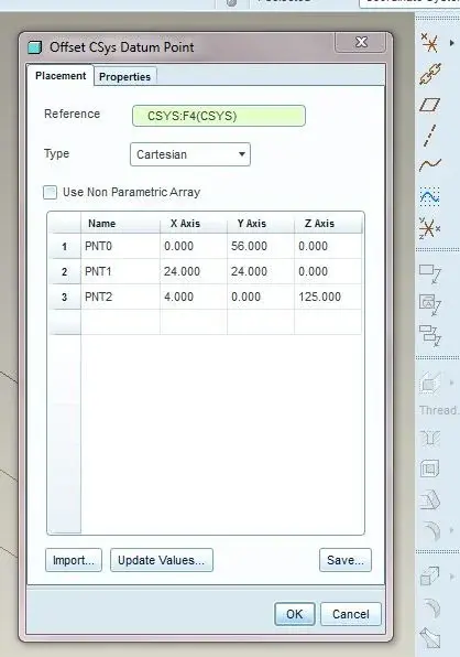

I have to make a pipe with unbeared pipes but straight cut to edge and then welded. the most suitable command seemed to me a simple sweep to constant sez but asks me the trajectory that must be in space and not on a plane. How do I create a trajectory in space? I know how to create points in space but I do not find the function that me join them in a trajectory with straight segments (often).
I have the wf3 m180
when I click on insert reference curve opens the window pzni curve-> across points-> end at that point I can choose between splines, osingle rays, multiple rays, whole set, add points. I tried but it makes me a curve, not a broken segment as I would like
I think you have to do the single strokes, 1st point > > 2nd point > confirmation with central key and so on.
Once you make individual segments, you can perform a sweep and variable section with the constant section option.
I've managed it, but for every stretch I have to restart the curve command and give only 2 points. for now I just need to connect a few points but it's a bit slender to make a feature for each segment. It's weird that there's no other way. cmq thanks to all
you have to create all points with one feature: offset coordinates points (possibly importing coordinates from files). and then create point curve with the ray=0 option. see attachments.
