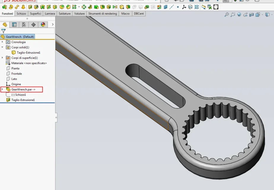

of course on the imported file you can do jobs but you cannot use the features of featureworks; this happens to always have the connection with the original file.
I attach a photo... where there is the red rectangle that indicates the connection of the import files.00.webp

solidworks 2016 .par opens them without problems and import them as a block. but you can sketch and make the changes you feel appropriate. I took some time to understand. The 2017 version hasn't put it yet so I don't know how history has changed.
