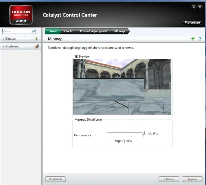

I had already tried to reinstall the catsettings without positive outcome, I solved instead changing the performance of the mipmap within the driver of the video card moving it on quality instead of on performance, I hope it can be useful to someone in the future.2013-06-21 09_08_09-Catalyst Control Center.webp
