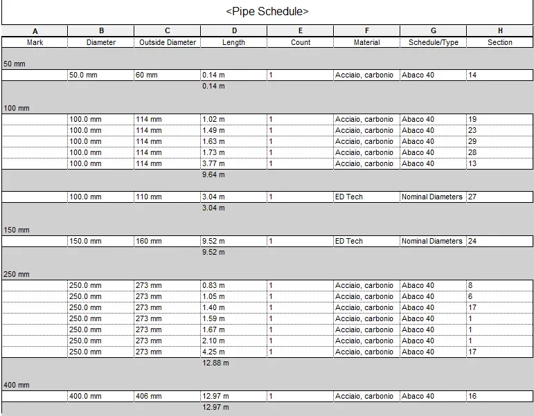

mir Guest Feb 16, 2023 #1 ciao! ce la posso fare... ho abacoset as follows:is that I would like the total for each type of pipe:I tried to reason ... I had to combine all chances by chance... but nothing Thank you. ♪

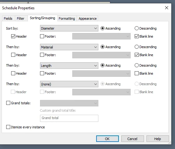

Tristan Guest Feb 16, 2023 #2 you need to flag "footer" under "length" and set in the combo box that returns the sum of values
mir Guest Feb 17, 2023 #5 but let's say thank you for your help! I tried as you say:But nothing! ... I swear I don't understand the logic of qyuesto filter!

Tristan Guest Feb 17, 2023 #6 access to the "formatting" tab and for the "length" field you have to activate the calculation of totals
